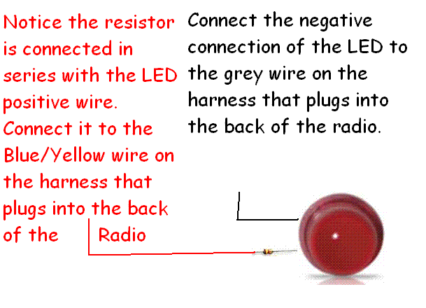

http://www.radioshack.com/product/index.jsp?productid=2062553   Go to radio shack and purchase the preceeding product.  Read the package carefully and notice the positive and negative of the LED.  When there also purchase a 1K ohm 1/4 watt resistor.  Notice the K in the value of the resistor.  I will draw you a simple non-chinese diagram.  and even give you the wire colors to connect it to.
how to hook up led light in car -- posted image.
if u would do that for me it would me nice. thanks
do i need to wrap the resister in electrical tape or shrink wrap tubing to make it insulated? how do i connect it to the harness? do i need to cut into the wire or just stick the wire into the prong? do i need a fuse? thanks
Platinum - Posts: 13,725
Posted: April 11, 2009 at 7:57 PM / IP Logged
Yes you need to insulate the resistor and the positive wire of the LED.  I do not think just sticking the wires into the harness is going to be a reliable connection.
