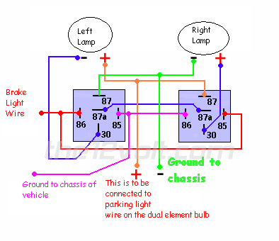

Yes that was the one I was asking about.  It would be very simple if you could change the sockets to accept a dual element lamp.  If that is not an option, we can still make it work with the sockets you have.  On the socket for the reverse lamp, are both the ground and hot wires accesible?  You will have to cut both and using 2 relays, will have to switch between series and parallel wiring.  When park lamps are on, the lamps are going to be wired in series.  Thus making the bulbs burn at half brightness.  When the brakes are depressed, they will be wired in parallel.  Full brightness.  There is a diagram on this site for switching speakers from series to parallel.  I will look at it and see if it needs any modifications to do this.
This is the diagram for the speakers.  It will take some modifications to make it do what you are looking for.  I have no problem modifying it if you tnink you are going to do it.  Let me know if I need to modify it.

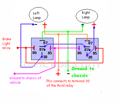

Posted: April 12, 2009 at 5:16 PM / IP Logged
We may need a third relay if you want this to work during the day.  When I drew the diagram, I was thinking you had daytime parking lamps.  A different post here. The diagram below will work at night.  I will need to modify it for brake lights in the daytime.
rewiring reverse lights? -- posted image.

Posted: April 12, 2009 at 8:45 PM / IP Logged
all wires are accessible, please do modify it for my application this is something i will 100% be doing.
thank you!

Posted: April 12, 2009 at 8:47 PM / IP Logged
thank you... the only change would be the lower pos connection needs to go to an ACC power wire rather then the park light connection, no?
Platinum - Posts: 13,726
Posted: April 12, 2009 at 8:58 PM / IP Logged

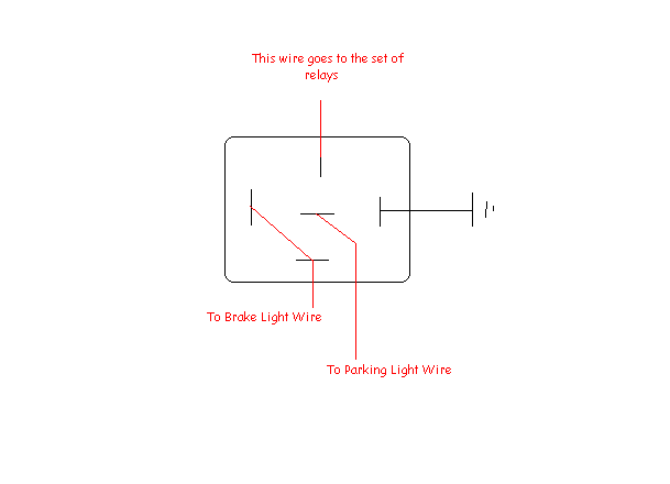

An accessory wire will be fine, the only problem with that would be the running lights would be on anytime the key is on.  I was thinking more in the lines of a relay that would supply voltage from either the park lights or when the brake is depressed,    Nevermind I will draw a picture.
Posted: April 12, 2009 at 9:16 PM / IP Logged
When parking lights are on, the lamps will get voltage from that wire.  When the brake is depressed, power will come from that source.  In the daytime, only the brake lights will illuminate.
