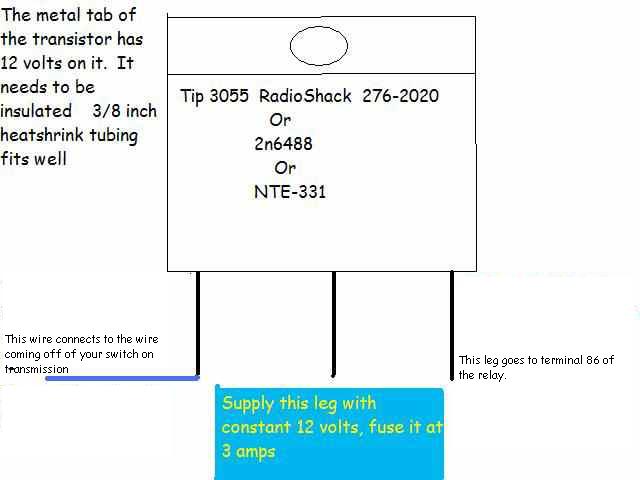

Can you get to the actual bulb on the dash?  Read the voltage across the bulb when it is lit.   If that is not easy to do and you feel comfortable doing a little soldering on a transistor that is available from Radio Shack I can get it to work for you.
reverse light activation -- posted image.
Relay wiring as follows.  As stated on diagram  right leg of transistor connects to 86 of the relay.  85 of relay needs to be grounded.  30 connects to 12 volt source fused at 5 amps.  Maybe 10 amps, do not remember about your lamps.   Terminal 87 connects to the hot wire of the lamp.  Ground the other wire of lamp if there is one.  If no other wire, it grounds through the mounting bracket.

I can't get to the reverse indicator bulb. But your transistor idea is very interesting! I will be trying that tomorrow. Thanks. I will keep you posted

(I am An idiot?) Your idea worked perfect, I didn't think it would but thank you for proving me wrong. Thank you very much!
