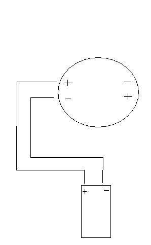

Yeah try this Take the speaker and put on voice coil on a 9v battery and see if it moves and if it does then do the other voice coil. (note while doing this listen to the coil and make sure it does not make any kind of rubbing noise when the coil goes up and down). If it does then the sub is bad or going bad. Hope this helps
DO this to each coil.blown woofer? - Last Post -- posted image.

1: If there is CONTINUITY, (which the VOM will also confirm) then the battery test is PERFECTLY usable. (one point for battery test) If you use a battery with a high enough voltage, you will also be able to find out if the voice coil is intermittent at the extremes of Xmax, which pushing on the cone with your hand, will NOT show. (one point off for the VOM, but one more point for battery test) With a score of 2 to -1, the battery test wins.
2: Speakers do not "put out" ohms. "Ohms" is a number describing the resistance presented by the wire within the voice coil. Sounds like somebody needs to understand better the parameters of electricity. Additionally, a "4-ohm" voice coil will NOT read 4 ohms with a VOM, it will be lower - typically around 3 ohms or so. The guy that does NOT know this will then think that his woofer is "broken" somehow.
BEST bet, AFAIAC, is the battery test. Use a 12V car battery if you can make some jumpers.
