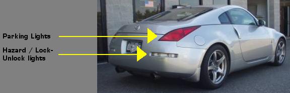

I have a 2006 350Z where I have installed a Compustar alarm/remote start (the 2W900FM-AS, I believe).  Everything is functional and working without any issues.  I connected the Parking Light output of the alarm to the correct wire to flash the parking lights with the alarm and to turn them on during the remote start.  But I have noticed since then that the way the factory key fob functions is that when you hit lock or unlock it doesn't flash the same lights....it flashes the hazards (which are different lights...see uploaded image for clarification).  I realize I could change the wire that I connected to the parking lights circuit over to the hazard lights circuit, but that when the car has been remote started, the hazards would flash (as opposed to the parking lights simply being on).  I guess this wouldn't be a bad thing though...
What I what to know is whether anyone has an idea on how I could get the hazards to flash during the lock/unlock, but have the parking lights turn on during remote start.  Is there is a simple way to direct the 12+ pulses to the hazard lights and direct the 12+ constant to the parking lights.  My first thought is to use a relay that would direct the 12+ parking signal to the Hazard circuit if the car is not in remote start (using the Status output from the alarm to indicate if it is remote start mode) and direct the 12+ parking signal to the Parking Light while it is in remote start.
Is there a better way?  Would this work?
2006 nissan 350z parking lights flash? -- posted image.

It's not the hazard lights, persay, it's the turn signals that flash.
Take your parking light output and diode isolate it to your left and right turn signals.  It will flash the turn signals on arm/disarm and then keep the turn signals on constantly once remote started.
If you really want to switch between parking lights and turn signals you should be able to install a relay and trigger if off the (-) status output wire.  Have the relay ouputs switch between the parking lights (87) and the turn signals (87A).  You'll still need to diode isolate the turn signals at the BCM.
