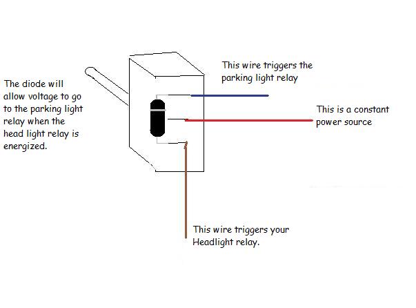

I'm looking to use a SPDT rocker switch ON/OFF/ON to allow me to have one switch that has Primary ( all led lights ) and Secondary ( rear led lights only ). I am planning to run the front 2 led lights to one side of the switch and the rear 2 led lights to the other side of the switch. Then use a rectifier diode to bridge from the one side to the other, so when I switch to secondary only the rear turns on, and when flipped to primary the front comes on and diode also allows power to rear so they come on as well. Is this a proper way to do this? Any thoughts or comments would be great. Thanks

Yes, that would work as long as the diode has enough current capacity.  If you are only running to small LEDs then it won't be a problem - a 1A diode will work.
If you plan to pull a decent amount of current through the switch you will need to keep the same conept but use relays.  You can diode isolate the relays so that it works the same way you described above, but since you are only switching a relay you can keep the small 1A diode.

Disregard the text about relays on this picture.  It was intended for using one switch for parking lights and headlights.
