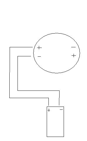

So i have 2 dvc 4ohm subs wired to 2 ohm and i have a 2 ohm stable 2 channel amp. The problem is the polarity is off the subs are hitting at different times and one subs is hitting harder then the other. Does anyone know how to fix the polarity???

ok This is a picture of what you have to do with each voice coil and subs.

Know if the speaker moves up you have it right but if the speaker moves down you have to switch it on the speaker. Hope this helps and if you need something else just let someone know and we can help

ok so if i do as the picture shows and i get both subs to move up which ever of the 2 voice coils i get to go up on i use those to go to the terminal??

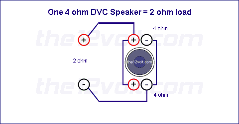

If a speaker is wired out of phase with another speaker, you will never see that it is out of phase with an audio signal.  The only way you can tell is it will be moving a lot and not making any bass.
Wire each woofer as in the picture below.  Connect each speaker to one channel of your amp.   After you wire the speaker, and before you connect it to the amp, touch the wires briefly to the battery as stated above.  Notice which way the speaker moves.  If the positive terminal of the battery is connected to the positive wire of the speaker, the cone should move away from the magnet.
Option 1 (parallel) = 2 ohm load
Voice coils wired in parallel
Recommended Amplifier: Stable at 2 or 1 ohm mono
sub polarity problems -- posted image.
Duplicate for the other speaker and connect it to the other channel of the amp.

one voice at a time
so take the 9v battery and put it to the wires on one voice if it goes up you have the wires right, if not then the wires need to be changed around.
FOR Example:
Positive on the speakers voice coil to the positive to the 9v (do this with the speaker wire that is hooked to that voice coil). DO the same with the negative wire to the 9v.
Got to do this to every speaker voice coil. Everyone has to move up it not change it to make it go up.
Hope this makes since to you
