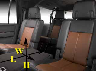

but if you give me LxWxH between the seats I make you something for the 2-12' let me know.

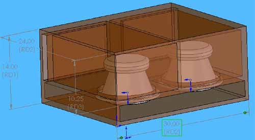

well if you want to put them between the seats I got something the I can design if you want them there. Just need to know LxWxH want to down size, 12'' woofers -- posted image.
this will hold 2 subs
Got the design done with a stealth look to it. No one will see the subs but will hear you and you will have the full back for things.

ok there are 2 of the first one is the stealth design and the out dims are 24w x 14h x 30d with a port of 1.5 wide so if you have room each sub is tuned to 35hz and 1.5ft^3per side and no one see what you got.

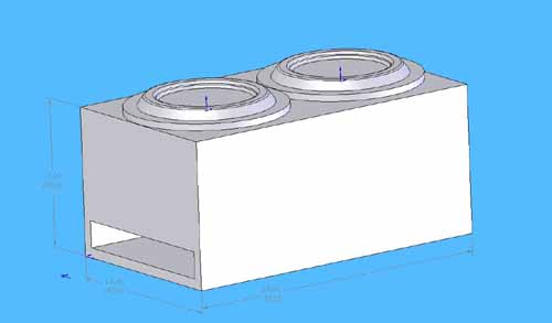

number 2 simple but that the dims are that you gave me it would have to be sealed or the port will go into the seat.

Thanks for the info guys, not sure what is cabin loading? I am just looking to move my subs to open up the back of my SUV. My current box blocks the access in the rear with the 3 12's in it. Vib you said that my current box is not the correct sixe for these woofers? It measures 47.5" W x 11" D x 14" H and does sound really good to me. C.F. on that box measures 2.212. I would like to do this once and have at least close to the amount of bass I currently have. I suppose it would be best to downgrade to 2 10" woofers for the size box I want to put in the middle console? I would like to stick to the smaller dimensions and could seal the box (second pic) Would the woofers have to sit on top of the box or could I put one in front and one in back?
