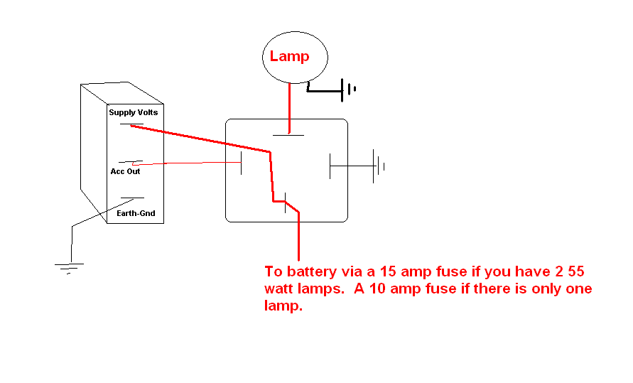

How about a picture?  Would that be dummy proof enough.     Do you know which wire on the switch is the ground for the LED?  There is also a positive feed wire, do you know which wire that is?       Give me about 15 minutes for the picture.

Wiring Relay for Fog Lights, Switch to 12 VDC -- posted image.

Ok...I think I understand where you're going with this, but let me put in my own lay-man's terms to be sure:
I connect one terminal of the relay directly to the wire that leads to the battery with a fuse, which I have - a 20 amp (bottom of relay diagram).
I connect the relay to something grounded (right side of relay diagram).
I connect the wire from the lights and ground the lights (top of relay diagram).
I connect the output terminal of the switch to the relay (left side of relay diagram).
That all makes sense, but looking at the diagram and reading what it says, I'm confused by four things;
1) - My switch has "Supply Volts", "On Acc." and "Earth Ground".  Which is the input and output terminal?  Grounding the switch is straight forward (thank goodness something is to me - for your sake!).
2) - I never had a 5 amp fuse connected when I had things wired in the Explorer and everything worked like a charm.  How necessary is this?
3) - It makes sense to have a wire leading from the switch to the battery, but when I had things connected in the Explorer, I only had one wire leading to the battery for power.  This diagram seems to indicate that I'll need two battery connections.  One for the relay and one for the switch.  is this correct?
4) - Which wires lead to the 30, 85, 86 and 87?  If this makes a huge difference, I don't want to mess it and fry everything.
Jarod
Platinum - Posts: 13,720
Posted: May 17, 2009 at 9:34 PM / IP Logged
1.  Supply Volts = Input terminal     On-Acc = Output terminal
2.  In a perfect world, not real necessary, but if something penetrates the insulation of the wire and it touches ground, a fire could be in order without a fuse.
3.  You can connect the switch's power to the battery wire at the relay.  If it is a 14 Ga. wire the single fuse will be fine.  I did not know if the relay was going to be close to the switch.  If the wire to the switch is smaller in size than a 14 Ga, a smaller fuse to protect that wire may be in order.
4.  The picture is drawn so the pins of the relay are facing you.  85 is on the right.  30 at the bottom.

You mention proximity of the relay to the switch in your last posting. I'll have them both under the dashboard, but how close is too close?  If I want to wire things up with what is seemingly your easy way of doing it, what's best in this regard?  Opposite sides of the firewall or just a few inches (or more?) away from each other?

You can attach the relay to the switch if you like.  It makes no difference how close they are.  I had no idea if you were mounting the relay under the hood.  That is why I recommended running both to the battery.
