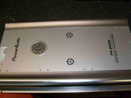

I do repairs for a local pawn shop, the owner called me and asked if I could pick up and amp and check it out for him.  I get there and ask what it is doing or not doing that makes them think it is broken?  The salesman replies with "The old grey mule just ain't doin what I know she should be doin.  I take the amp from him and immediately notice the lack of weight.  I think boy is this going to be good.  I get it to the shop and put it on the bench and notice right away that it is just as I suspected, a chip amp.  Meaning that it has an output chip just like a radio.  Max 18 watts a channel.  It is working just as it should, for a chip amp that is.  I have seen many 14 inch amps with 8 inch circuit boards inside them.  I almost did not remove the cover from this jewel.  I am glad I did.   This amp was about 20 inches long.  As you can see in the top picture, it is rated at 1600 watts.  It has a single 40 amp fuse on the end.

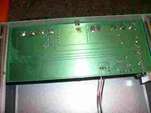

When I removed the bottom cover, I was expecting similar, but there was way less than I expected to see.

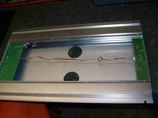

The following pic is of the actual amplifier board.

Wow, that is one amp that should NEVER overheat.  I hope they were using a steel (or should I say steal) heat sink as aluminum would make that thing weigh nothing.

Nope it was an aluminum sink but it did have a steel bottom cover, still in all it weighed next to nothing.

There was SO much DC on the outputs, and he was driving it SO hard, the voice coils of the stocker Ford speakers overheated to the point of catching fire. We disassembled this swap-o-rama special to find the VERY MINIMALIST power supply, and a big ol' 4 channel bridged STK chip in there... It, IIRC, was marked 2000 watts! Its fuse rating? 20A.
At least they isolated the audio inputs from that big noisy amplifier end... :)

That's classic.  Gotta love the flea market.  I especially like the "1600 watts" claim on the front.  buyer beware -- posted image.

Came back to giggle again... Noticed the (I'm sure) VERY effective ventilation holes, and the extreme care with which they covered them with the felt... to keep foreign objects away from all that high-current circuitry.
