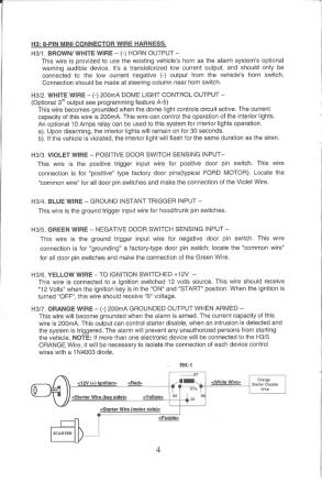

Ok, I have installed a Autopage RF-315 alarm system into my car, partially. The problem I am having is the starter disable wiring. In the book of the alarm and on the relay , it states that
red=12v+ignition which wire is this and where?
yellow=starter wire (key side) which wire is this and where?
purple=starter wire (motor side) which wire is this and where?
white wire to alarm orange wire brain
The only one I understand is the white wire that goes to the orange wire coming from the alarm
Also, on the wiring diagram for my car, I noticed that the head lamp is blue and it is on the left of column blue connector. the book states it needs a relay.
Do I wire this as I would any relay for a negative door trigger? Other than that, everything else is working flawlessly.
See attachments for the wiring diagram of the alarm

the starter wire would be located in the main ignition harness, you could trace from the back of the switch where you insert your key to start, the colour wire you're lookin for is BLACK/ white, cut it in half at a suitable point where both ends can be reconnected to the relay, yellow goes to the side coming from the keyswitch  the purple to the other side, the red tap this feed on to the thick gauge BLACK / YELLOW wire frm the same harness.
i don't understand your last question about the relay and the headlamp and the door trigger, please clarify.

When you say "purple to the other side" which wire is that? Color?
The other question I was asking was about the domelight. Is that referred to on the wiring harness from this site as the "headlamp?" If so, I see I have to wire a relay for that

purple to the other cut side of the starter wire, the side going towards the engine to the solenoid, the domelight i did one a while back, didn't use a relay though, picked up the door and trunk contacts behind the iinstrument cluster, diode isolate all four, bands facing away from alarm, also not too sure about your haedlamp statement, but use the parking lights or hazards. cheers

Constant 12V+White Ignition Switch Harness or Fuse Panel
StarterBLACK/ White Ignition Switch Harness
IgnitionBLACK / YELLOW Ignition Switch Harness
AccessoryYellow Ignition Switch Harness
TachBlue Distributor
Brake SwitchGREEN / WHITE Brake Switch
Trunk PinORANGE / Silver (-) Right of Column Gray Connector
Parking LightsRED / Black Fuse Panel Blue Connector
Head LampBlue Left of Column Blue Connector
Hood Pinn/a
Door TriggerBLACK/ White (-) Right of Column Gray Connector
Door LockBLACK/ White (-) Gray Connector above Fuse Panel TapeD to Harness
Door UnlockOrange (-)
Horn WireGREEN/ Blue (-) Left of Column Gray Connect
