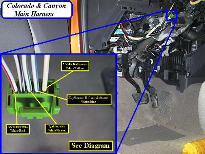

Going to the fuse box is probally the best idea. I just wanted to upload a pic (havent done it yet:P)
Pic is of the ignition switch w/ diagram
