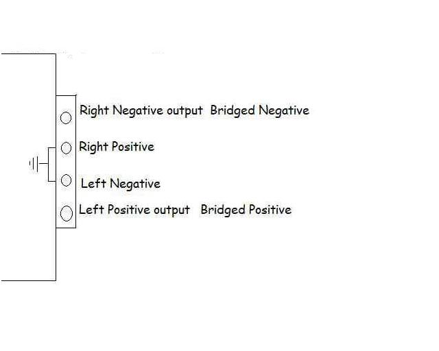

Following is a diagram of any bridgeable amplifier.  Notice the left negative and right positive terminals are both ground.  A  2 Ohm load on left and a 2 Ohm load on the right, will read 4 Ohms across the bridge terminals.
what fuse size for amp? -- posted image.

i am an idiot wrote:
Yes a 2 Ohm mono load is the same as a 1 Ohm stereo load.  Yes the amp running 2 Ohm mono will make it put out some insane power.  You said you have had it connected that way for years.  Aren't these woofers new?  Were your ald woofers 8 Ohm?
Following is a diagram of any bridgeable amplifier.  Notice the left negative and right positive terminals are both ground.  A 1 Ohm load on left and a 1 Ohm load on the right, will read 2 Ohms across the bridge terminals.
