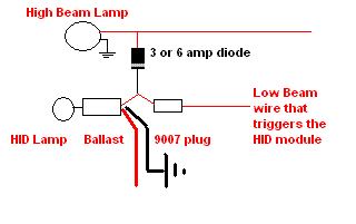

Since the HID trigger wire probably pulls very little current, you should be able to do this with one diode per side of the vehicle.  I would still use at least a 3 amp diode.  Radio Shack sells 3 amp and 6 amp diodes.  Go pick some up and I will draw you a picture.

So just stick the diode between the low and high + on each side? Any other way to do this? I don't want to start cutting up this harness if I don't have to.

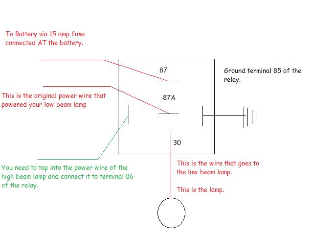

There is another way to do it, but since you need very little current to trigger the HID module, I think a relay will be wasted effort and money.  I think the diode is the simplest and most cost effective manner.  The relay will involve the same cutting of the harness.
