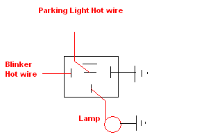

is it possible to have a relay diagram so i can convert to blinkers? do you know where i can find this
Platinum - Posts: 13,726
Posted: June 18, 2009 at 4:16 PM / IP Logged
honda bike parking lights -- posted image.
