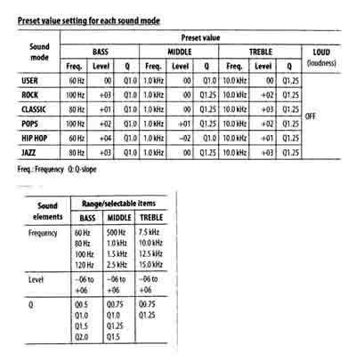

I understand that there are tons of posts on how to set gains, but that not exactly what I'm asking. I need help on where to begin to adjust the gains along with a parametric eq on my particular system. I hope someone can help me bacause I am about to pull my hair out  because I just can't get my system to sound right. Before, I was using a factory head and the tonal quality sounded way better than what I have going on now. PLEASE HELP!!!!

The head unit has a parametric eq on it with the following ajustment options:
guidence for setting gains -- posted image.
I had to upload an image because I wanted to make sure everything was understandable. Anyway Here are my questions:
What would be the best crossover setting? What do I want to have the eq set at when I am adjusting my gains? Can I use test tones, and if so which ones? I do hope someone out there can help me. Thanks all.

Start simply, with the basics.  Setting gain has nothing to do with crossover settings or parametric equalizers.  The goal is simply to match the deck's highest clean output to the amplifier input so that they work in sync to provide full power without going into clipping.  Set the amp gain, then work on crossing over the sets of speakers.  EQ comes wayyy last.
