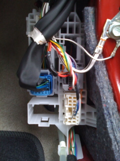

Posted: June 27, 2009 at 6:01 AM / IP Logged
You've found the Corolla motor wires, look at plugs in DKP, probably green and brown, grounding them will lock and unlock the vehicle.

Posted: July 02, 2009 at 8:40 PM / IP Logged
Ok here's a photo of the DKP wires. I found the Red and Brown on the grey plug, but they were the wrong ones. I thought I checked everything but obviously not. Any ideas where the right ones would be?
Cheers!
