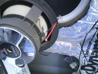

Thank You. I thought so,but thinking can sometimes be catastophic.figuring port length -- posted image.. So any pros or cons to this design other than rear deck vibration and more than likely losing the 6x9 connections? I plan on eliminating them for compononts later anyway.

Ok with this design I will be able to go 15" high to allow 2" clearance for driver movement. I figured a port opening of 4.5x13.5 for 60.75 sq inches, 25.5 deep puts me a little over 32 hz. Will this be be ok or am I pushing the driver too far? I am planning to resin the interior of the enclosure and adhere polyfil. I am looking for a low deep bass responce,without putiing too much stress on the driver.

So I came up with a gross enclosure of 6.13ft3^ port is 60.75 sq inches tuned to 35hz. Will this be ok for this driver/amp combo, or am I asking for trouble? I don't want to keep building enclosures, it is quite a bit of work just getting them into my car. I figured on a 5ft^net,   .3 for driver/brace displacement, and  .82 for the port displacement. That was 6.12 gross. Will the difference in my final design affect the performance that much?
