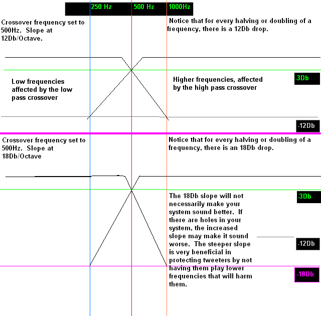

Platinum - Posts: 13,726
Posted: July 20, 2009 at 10:37 PM / IP Logged
I decided against an "In Death paper" and opted for an slightly "In Death Picture"   Hope it helps.
crossover slope -- posted image.
