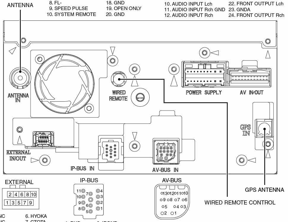

I want the HU to control the DVD player as well, though. Plus the AVIC-D1 does not have a composite input. See diagram of the rear connections attached (I hope).

The a/v in out plug on the top right of your diagram is where the composit in goes.  Only the pioneer unit will let the D1 controll it.

This is the link to the wiring on the d1.  Page 17 shows the composite input.  I don't ever remember having to move anything on the power harness.  I think you just plug it in, no tricks.  All the rca in's are in that second plug.
