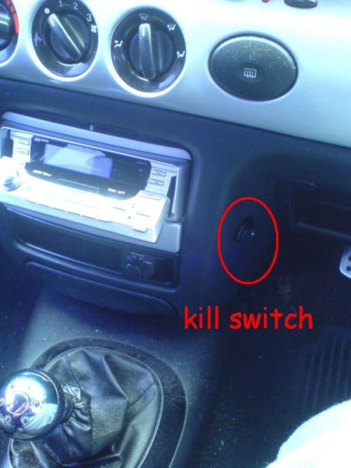

this pic is just to give a better understanding of what im at :
ford escort mk7 , euro model , year 2000.
car aerial, grounding the headunit. -- posted image.
i undertand what your saying, i really should have tapped into the yellow wire first.
but i went with the ground, as this stops all current from flowing. never thought that the aerial connection was grounded :(

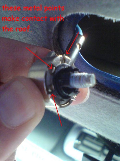

i opened up my aerial connection. i found that the connector has raised sections which make contact with the bare metal of the roof.

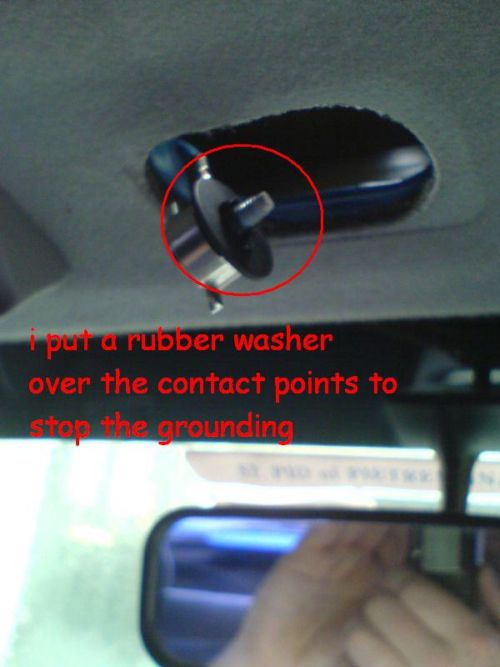

searching my shed, i found a rubber washer.
i then put a rubber washer over the contacts, and tightened up the connection again.
is this ok to do?
does the radio connection really need to be grounded ?
the killswitch works perfectly now, and ive noticed that i dont get any clicking noise when i put up the volume.
( if i turned the knob up , each time it'd 'click' or make a 'pop' noise )
i also dont get much hiss from the radio stations. it was worse before-hand. in fact, the stereo never sounded better or cleaner.
even the cd player has improved , especially the bass.
cheers for the reply and thanks for future posts  :)

You are going about this the wrong way. As previously mentioned, you need to open the battery feed to the radio. The antenna must be grounded for proper radio reception. You have effectively cut your reception in half by doing what you have done. You could damage your headunit doing it your way. The radio will try and find a ground path if it can, such as through RCA cables. This can result in circuits drawing to much current and harming them. Unless your vehicle sits for months on end without running, the batery feed to your radio won't kill your battery.It probably only draws one or two milliamps. To make sure that you don't have any problems, do a battery draw test on your vehicle.
