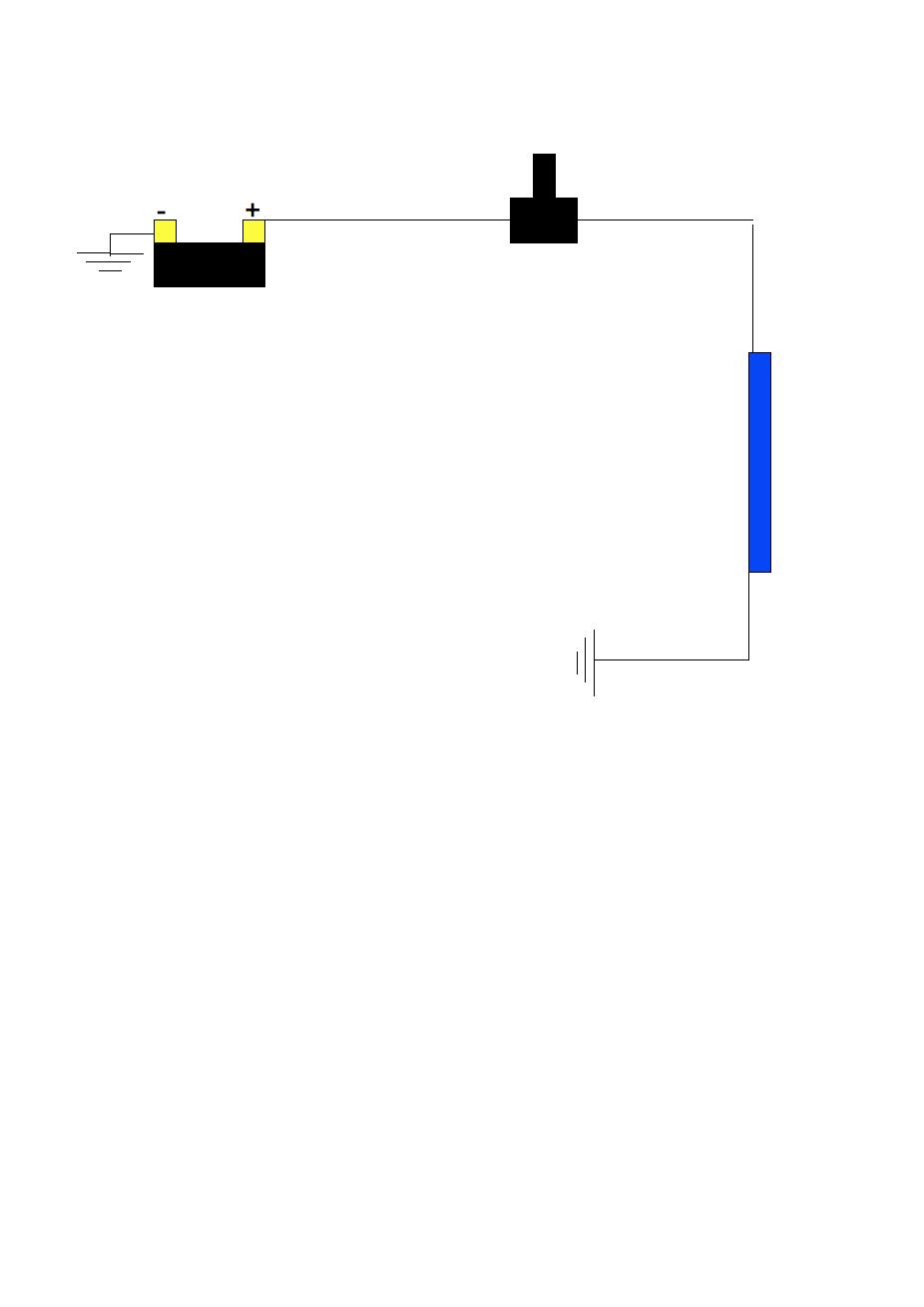

Hi i'm still sort of new to the lights part of ICE and i was wondering if the following wiring diagram is correct for wiring a neon with a toggle switch.
Thankyou to anyone who can help =)
correct wiring diagram? -- posted image.

Looks good.
Ideally you would have a fuse as close to the battery as possible to protect the wire, but other then that it looks ok.

Ow ok. How many amps do you think i should put in it? sorry im really new to all the lights stuff. Would 10 amps be enough? or is that too much?
Also if i wanted to wire multiple neons onto one switch. Say 4 then would i need to make seperate circuits? or could i just wire all 4 positive ends to the positive end of the switch?
Thankyou =)

The fuse size depends on how much current your light will use.  Typically, you shoot for about 25% more current then the device is rated for, but there is quite a bit of wiggle room in that number.
As long as the current rating of your switch is high enough you can run all the lights in parallel.  Typically, neons use very little current, like 0.5A a piece.  Four neons, at that current rating, would put less then 2A on the switch and a 5A fuse would be more then sufficient.

Ow ok. Well the switch says it holds 10Amps at 12V so i'm guessing that will be sufficient yes?

I've got another questions sorry. What if instead of getting power directly from the battery, i tap into the positive wire of the cigarette lighter? will it still work in the same way if i ground it properly?

Yep, it will still work the same way.
