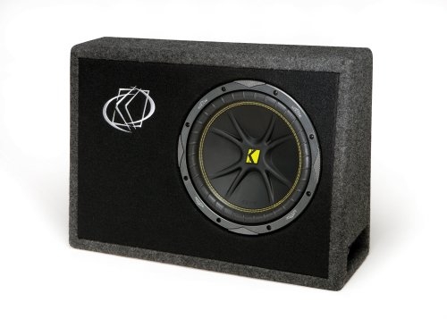

Ok, so I've done some calculations, and some figuring. I need some help though on the ports. I'm doing vents. I'm not sure how you HAVE to do vents? Can they just be straight? Or must they wind and stuff throughout the box? Here's my idea... Tell me how it sounds.
Here's pictures as reference first of all...
port, vented enclosure -- posted image.

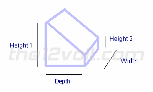

I'm basically taking the above idea, and building a custom truck box for my 2 12" Power Acoustik STW-12's. So the box will sit up like that one does, not like the picture below does, but if you flip the box below, you can see how it would sit.
Again... Flip the above image to look basically like the Kicker Comp's.
Height 1: 8"
Depth: 17"
Width: 32"
Height 2: 5"
Box Volume: 1.36791, so this gives the subs some room to breath, they'll be in a common chamber. If I divided the chamber in 2 it'd only be like .56 volume, which is well below what these subs require.

My ultimate question now is, Can I just cut out that rectangular cut out, like on the Kicker box... And just take like 3 strips of wood (keeping them so they make a long chamber with that rectangle just straight through the bottom of the box.)? Or must they intertwine throughout the box like I've seen in photos?
