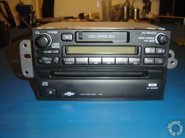

My friends
I solved the problem already. I got a double din plug & play toyota stereo that exchanged for the Alero stereo, I only paid $40 more, so total $60 alero stereo -- posted image..  Good enough sound. My truck can sleep outside safe and I can sleep alero stereo -- posted image. or work alero stereo -- posted image. in peace.
It really upsets me alero stereo -- posted image. when companies try to take your money with dirty maneuvers like Gm does with those VIN coded stereos and I find the way out of their clutches.

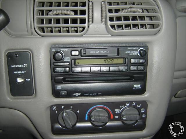

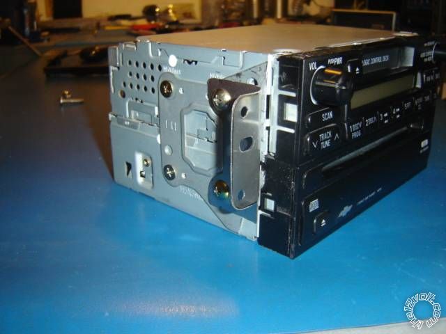

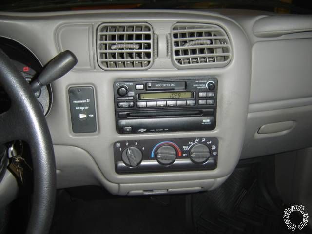

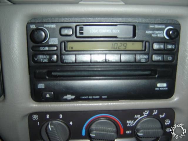

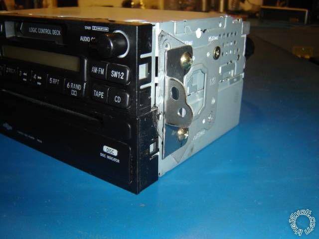

Posted: September 06, 2009 at 5:32 PM / IP Logged
I fabricated new brackets, erased toyota name and painted a Chevrolet emblem.
Take a look at the pictures
