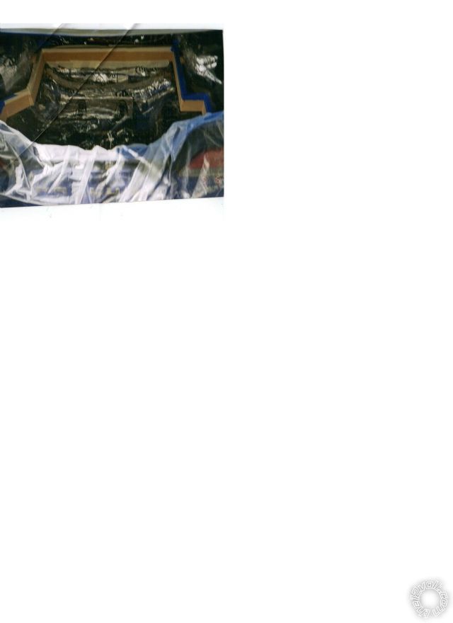

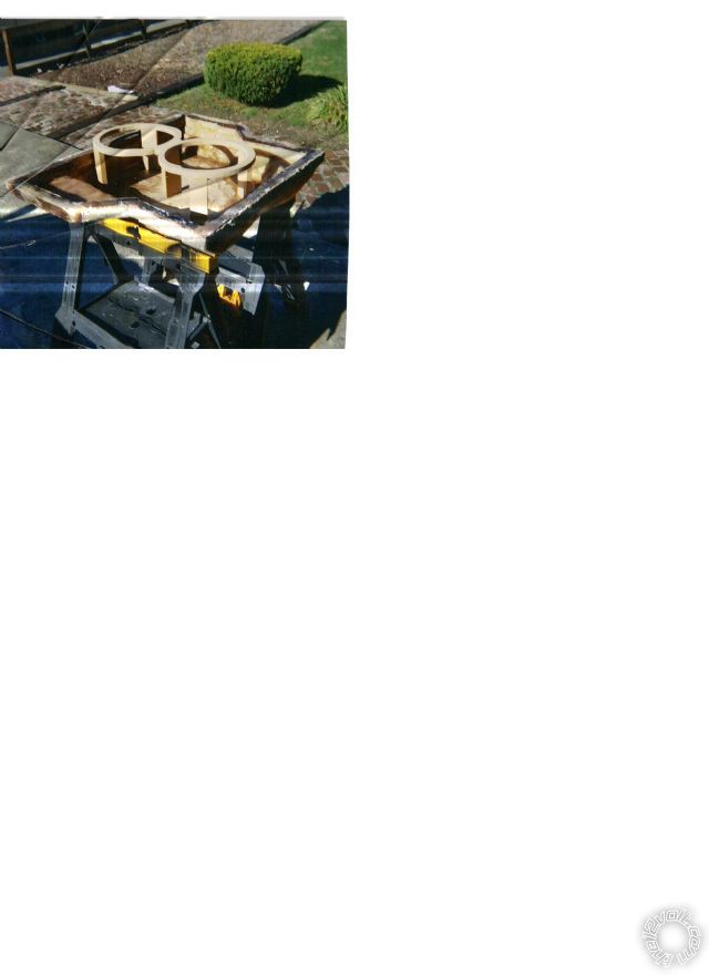

You can use a wooden frame that runs around the top perimeter of the spare well. Problem is your frame is circular. If you raise the floor 2", then you can use 2x2 to make a frame around the well. The fiberglass would then be applied in the well and up around the top and end on the wooden frame. Then the sub baffle screws down to the 2x2. Make Sense? Here's a couple pics of tubs I've done like that. Sorry they are old.

Thanks. That makes sense and was kind of what I was thinking. I can basically use a 3/4" MDF ring the same size as the inner diameter of the wheel and fiberglass to that. Then once completed, I will attach the baffle to that. I am really looking forward to doing this. I was going to build mine, but when shop quoted me just a few $ more than I could buy the material for, I let them do it. They did a great job and built me exactly what I wanted, but regret not doing it myself. Thanks again, will post pix once done.
