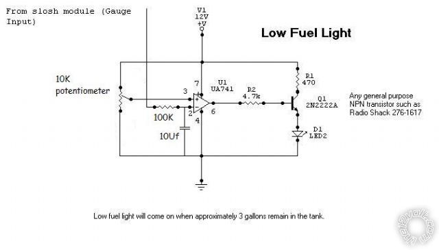

There is a post on here somewhere from "I am an idiot" that shows how to make a low fuel light based on a change in resistance (it's an op amp circuit).
You can use the coolant switch as one half of a voltage divider and then use the voltage divider output to feed an op amp.  The output of the opamp can drive a transistor that drives a relay.

i actually saved that schematic you are talking about KP. here it is
relay, coolant level sensor -- posted image.
