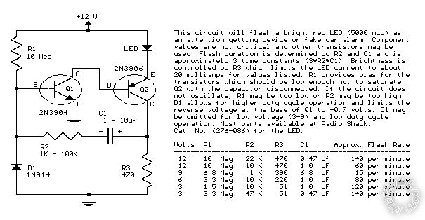

A Relay switching that fast will make a soundnd like a buzzer. Better to use a couple of Transistors.

You could just use all transistors to do the job.
