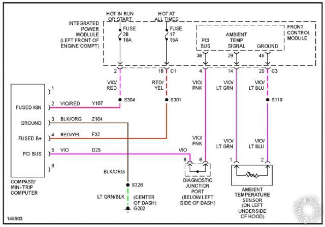

I am looking for the specifics to wire in the outside temp sensor on my 2002 Dodge Ram 1500.   I got the overhead console out of a 2005 3500 Ram
Everything else works and I have the sensor out of the donor truck too.   I just can not figure out where to connect it into the system to get the overhead temp to work correctly instead of reading it is 130 degrees out all the time..   It was 45 here last night..

I think this is what you're looking for
ambient temp sensor 02 dodge ram -- posted image.

Yes that is what I have been looking for Thank you..
