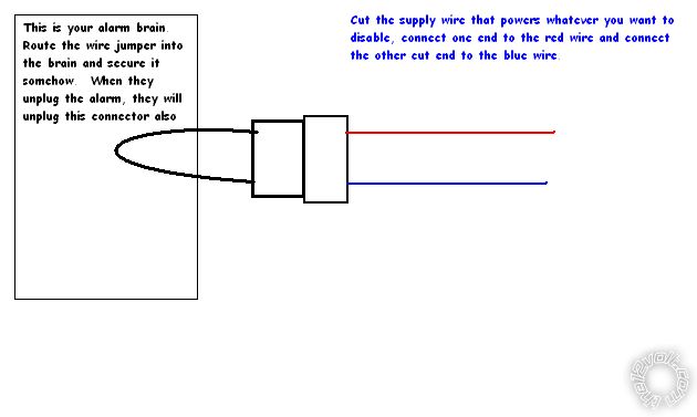

Go to Radio Shack and purchase this and it's mate. http://www.radioshack.com/product/index.jsp?productid=2103292
deadman circut? -- posted image.
Platinum - Posts: 13,725
Posted: October 02, 2009 at 7:18 PM / IP Logged
I guess I could have saved a lot of time had I read 911's post.  Same principal, but the radio shack plug will handle more current than the alarm harness.  With the current required by some of the newer fuel pumps, I would highly recommend the larger capacity plug.

i love that idea, nice and simple, its easy, and it get the job done without throwing any electronics in to go wrong. thanks man!!!!
