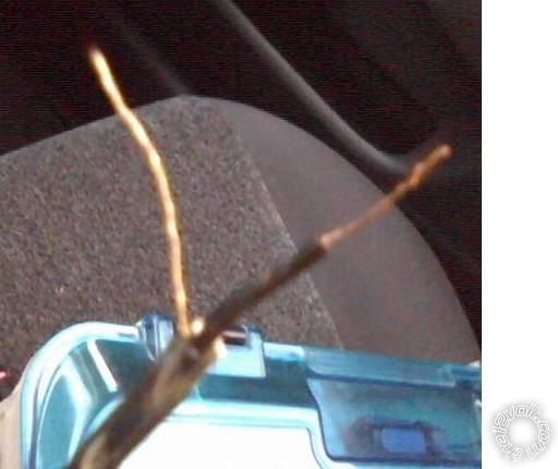

rca cables - Page 2 -- posted image.
this is wut im workin with..

picture wont work... but all it is is clear insulation, bare wire, black insulated wire

The black insulated wire is the center conductor and the bare wire is the shield.
Your picture did not work because it was wider than 640 pixels.  I had to crop it so it would post.
