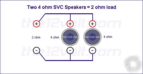

I have a mono kicker amp that at 2ohm puts out 400w. I am looking at purchasing two Kicker Sealed truck enclosure with one 8" CompVT subwoofer. They each handle 200w RMS at 4ohm and are single voice coil.
Would I still wire these up like the drawing below to achieve getting 200w at 2ohm to each?

yes
