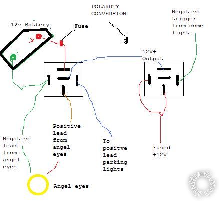

capacitor + diode? -- posted image.
hey guys. can anyone help me out with this? i have a mitsubishi eclipse 2001 with angel eyes installed. basically, what i want is to have my angel eyes on when i turn on my parking lights, and at the same time when i lock/unlock/open the doors. i think i have everything wired correctly. problem is that the relay used to convert polarity from dome light (negative trigger to positive output) buzzes whenever i close the door. i read some posts where you recommend using a capacitor+ a diode to avoid the buzzing. above is a diagram showing my setup. could you please tell me where to place the capactor and diode? do i need to add a relay? also, what changes you guys think i should make? thanks in advance and have a great day!!!

Simply add the following capacitor and diode to the right hand relay of your picture.  Disregard the text about the old domelight wire.
https://www.the12volt.com/installbay/forum_posts.asp~TID~114184~KW~relay+chatter~PN~0~TPN~3#555333
