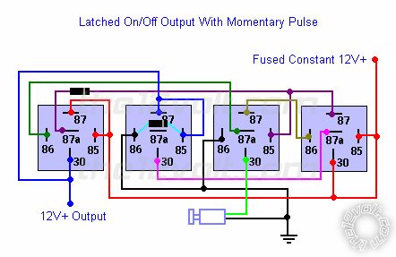

ckeeler
Gold - Posts: 1,461
Joined: June 20, 2008
Posted: October 07, 2009 at 9:27 AM / IP Logged
you can use this setup to accomplish what you need
latching relay problem -- posted image.
eddi38
Member - Posts: 6
Joined: October 07, 2009
Posted: October 07, 2009 at 12:22 PM / IP Logged
just looked at above circuit would green and black represent + and - output from the reciever? Then 12v red and blue be replaced by 240v a/c in and out,typically using 4 identical 8A 240va/c switching relays?
eddi38
Member - Posts: 6
Posted: October 07, 2009 at 12:33 PM / IP Logged
Ok my bad dont reply with abuse my error what i just said is wrong that would mean 24va/c going across a 12vdc coil,my bad:),this is used to power the main relay which switches the 240va/c ,i think please reply to confirm. Ive not used relays like this b4.
KPierson
Platinum - Posts: 3,527
Joined: April 14, 2005
Location: Ohio, United States
Posted: October 07, 2009 at 12:39 PM / IP Logged
The 12vdc output would drive your relay that controls the light.  So, in addition to the relays above, you would need a relay(s) with a 12vdc coil and contacts rated to at least 240vac and 5A.
In all the years I have been on this forum I have never seen anyone post that they got this relay configuration to work, so if you use it and it works be sure to post back.

eddi38
Member - Posts: 6
Posted: October 07, 2009 at 1:25 PM / IP Logged
could anyone here draw this as a circuit diagram showing coil contacts and switching contacts having to refer to a little drawing of a relay then looking at this wiring picture is hard ,anyone game?

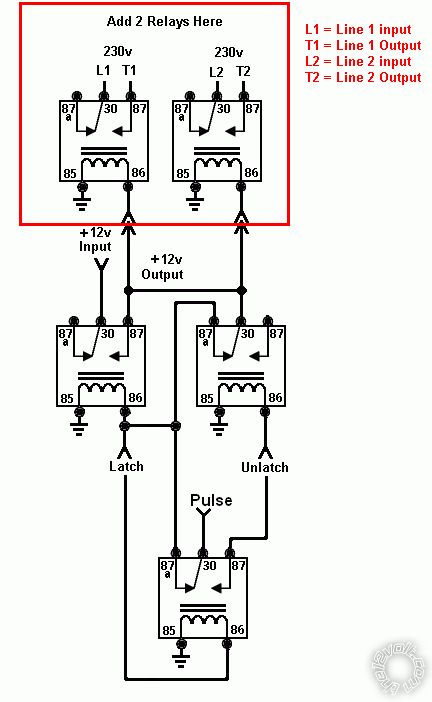

hotwaterwizard
Silver - Posts: 1,350
Joined: December 11, 2003
Posted: October 10, 2009 at 2:01 PM / IP Logged

eddi38
Member - Posts: 6
Posted: October 11, 2009 at 3:12 PM / IP Logged
Thnx for giving it a go but you have missed out a relay and 2 diodes i just looked it over and it wont work, i said it is a 12vdc pulse coming out of reciever and i want to switch 240v a/c this will not work i need this circuit to work switching a 12v dc coil which then switches a 240va/c load.please try again for me .
hotwaterwizard
Posted: October 13, 2009 at 12:49 AM / IP Logged
