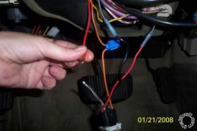

Okay I am now pretty sure I have gotten the brain disconnected so there must be another problem. I  had a Backyard Joe remove it (Of course he knew EXACTLY what he was doing... camry 94 need alarm excorcism desper -- posted image.)and now my car still wont start. Wont even turn over. Halfway through the process his girl got mad and he left the job with wires (A big red one under relay (?) for ignition (looks important but I dont know) hanging out and I didnt want him back. He disconnected the wrong wire by accident maybe(?). Does anyone know what the wiring should look like right under the steering column by a relay?Anyone know where this red wire goes? Simplest laymans terms would be greatly appreciated as I am a girl relying on common sense only, not expertise.Thank You!

I can't let you be tortured any more.  Once you pull the alarm off its plug, look to the BLACK/ white lead from ignition switch to fusebox.  Can't be more precise because ours were on the other side of the car!  Make sure there are no cuts and if there are rejoin. N.B. This is assuming that the various warning lights come on but the engine wil just not turn over.

OK I was right as usual,  look at the picture, your BLACK/ white has been cut and joined, to a red and black via the blue tubular (butt) connectors on the right of the picture. Join the black to the red, remove that awful square blue connector with its orange wire, the block at the bottom is the immobiliser relay base, just remove. you're up late, it's 8:45am here.

What happened...I kept the phone by my side but no call...Then you let the backyard guy touch it...? *shaking head*...Anyhow howie said it best...Cut the red and black from the box/sqaure/relay at the box...Strip wire and solder...Just kidding...But you should at least crimp that connection...!
