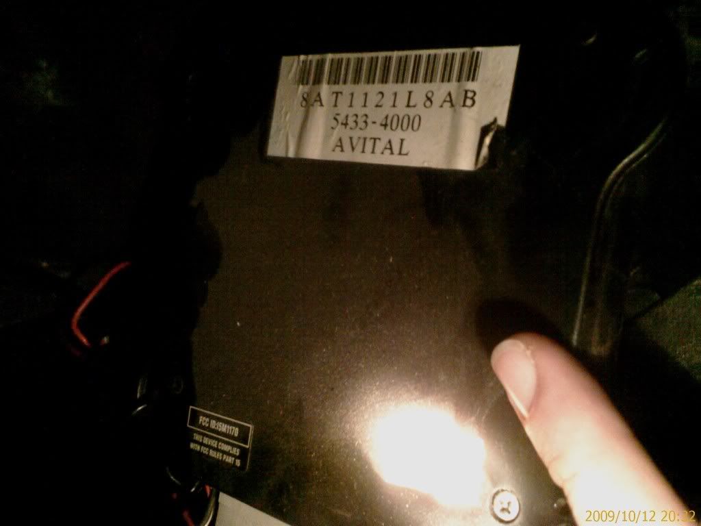

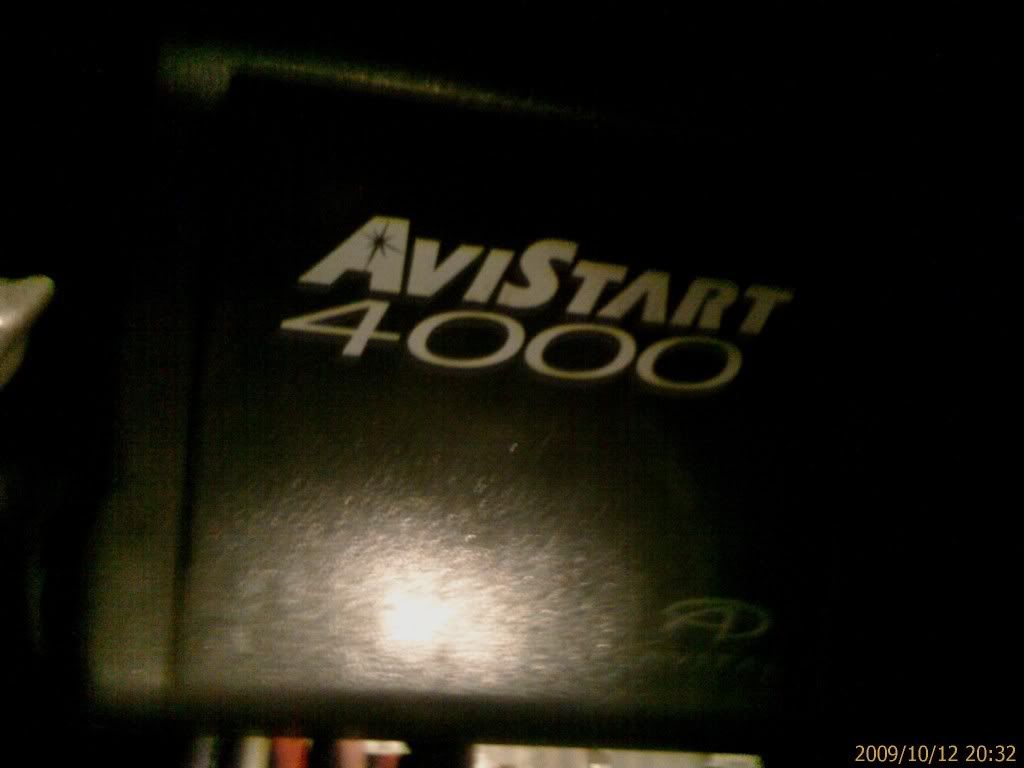

Can you post a picture of the brain? That unit is probably from when Avital was not owned by DEI. I may have a remote laying around here but would like to see the brain first.

Here's a pic of the front and back. Sorry for the crappy pics, it's dark and with my phone. It doesn't have DEI's name on it anywhere..

That unit is back from before DEI acquired Clifford/Avital. I had a 6500 and a 6501 at one point. Great units for their time.
Those remotes are going to be extremely hard to find. I looked into it about 6 years ago without any luck. At one point DEI sold a replacement remote that worked but looked a little different than the original remote. It was more shaped like a finger.
The original remote looks like this:
Link
I had an old one sitting in my toolbox that I sold about a year ago.
You may want to google "FCC ID I5M5659" for other results.
The modern DEI remotes will not work. Apparently DEI brought back the model number Avistart 4000 but the parts are not compatible,
