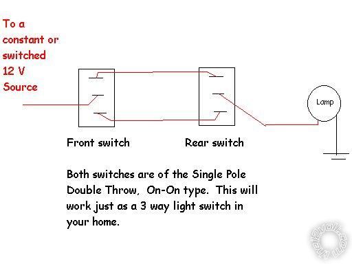

i have one 12 volt light and want a switch in front and back of trailer
Posted: October 29, 2009 at 3:26 AM / IP Logged
Constant feed, send to light unit, ground wire, split into 2 and run one to each end via switch, job done.
Platinum - Posts: 13,723
Posted: October 29, 2009 at 3:46 AM / IP Logged
trailer wiring -- posted image.
