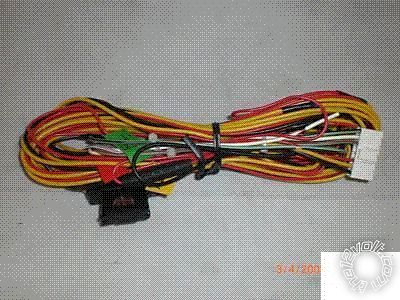

hello, i don't have the power harness for this but im going to solder some wires on it.. can anyone tell me what the wire colors for this harness are from right to left or left to right.. better yet does anyone have an installation manual for this unit.. thank you..
the harness is cde6979 if you have one please amail me the info.. thank you for your help..

How many connections are on the monitor?  Do you have an ohm meter?  Do you know what signals the unit requires to operate?

its got 8 pin connector...
here is a pic of the connector on ebay
harness is cde6979
http://cgi./Pioneer-Power-Speaker-Harness-Car-Audio-CDE6979-NEW_W0QQitemZ320410785324QQcmdZViewItemQQptZLH_DefaultDomain_0?hash=item4a99f8962c
Platinum - Posts: 13,724
Posted: November 01, 2009 at 3:01 PM / IP Logged
Just a hunch, with the locking tab at the top, and the wires facing you.  From right to left, Black, Yellow, Red  Open open Brown, White, Grey  The Brown and Grey may be a different color.  I can make out all the other colors

i can see the colors,lol.. i need to know what they are for ??
yellow constant red ignition black ground, etc!!!
Posted: November 02, 2009 at 5:46 AM / IP Logged
http://www.pioneerelectronics.com/PUSA/Unassigned+Content/ci.AVR-W6100+Owners+Manual.Protected
Page 30
