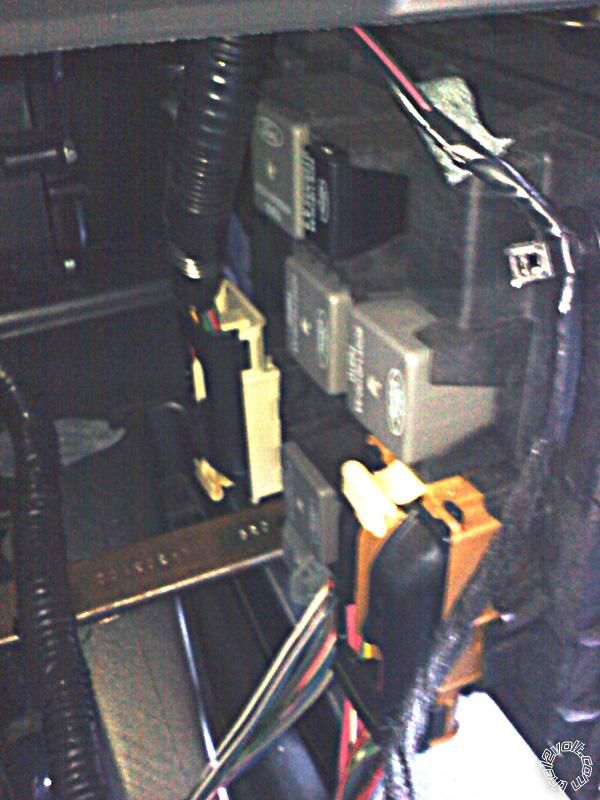

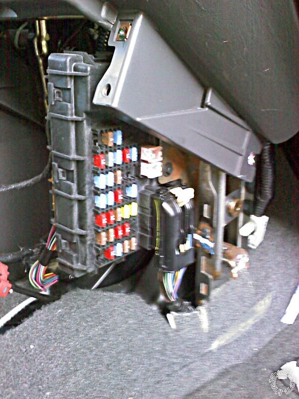

I am installing an aftermarket remote start on a 2006 Ford Escape. I have found the wiring chart. I took the center console apart and found the SJB which is where most of the connections are made. I, however, cannot figure out what connector is which. As an example, the chart refers to connector E but I can't find which connector that is. Does anyone know? I took a couple of pictures of it if anyone can tell me which connector is which. I want to be sure before I start making connections to the factory harness. Sorry the pictures are a little blurry. I took them with my camera phone.

everything you need you can find in the drivers kick panel, they only list it at sjb because its guaranteed to be there...

metz is right, everything is located at the ignition collumn, and kick panel. the only thing that the sjb is good for is the door triggers, but door triggers can also be found in the kick. you should never assume that the coloured wire will be in that connector. get a dmm and start testing for the wires you need. nothing better than verifying so you dont destroy the sjb.

Thanks for the replies. I didn't know I could find everything at the kick panel. Hadn't even thought of it. The list said SJB so I was just going to do it at the SJB. Thanks for the help.
