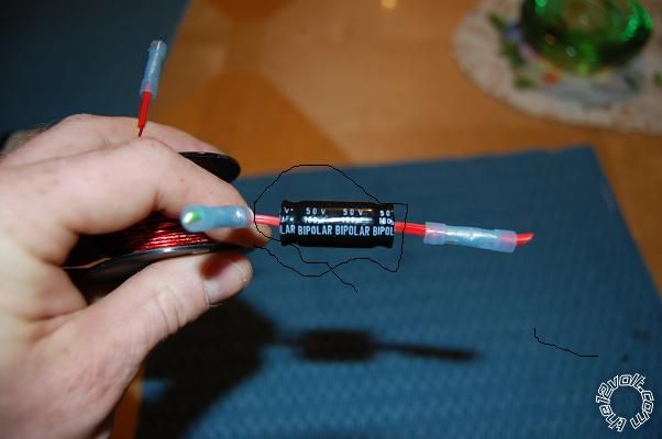

does anybody know what this is?
spmpdr
Copper - Posts: 456
Joined: March 22, 2009
Posted: November 03, 2009 at 1:19 PM / IP Logged
I know its a crossover setup of some kind ,It has no identifying marks on the resistor and states 50v 100 uf biploar on the capacitor

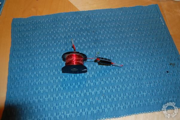

does anybody know what this is? -- posted image.
Those are the pics.

DYohn
Platinum - Posts: 10,741
Joined: April 22, 2003
Posted: November 03, 2009 at 5:59 PM / IP Logged
Those are crossover parts.  The first picture shows a capacitor, the second picture shows a capacitor and an inductor.
