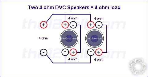

Ok I have two 4ohm DVC subs that i need to run into a pdx 1.1000. I know the simple way would just wire it up using the diagram below. But the PDX 1.1000 has two speaker outputs instead of one. Is there any way that i can wire these subs up using both of the speaker outputs? Please be specific like what wire from each coil goes where cause I'm not very good visualizing series and parallel. If you can edit this pic in paint to how it needs to be. two 4ohm dvc to pdx 1.1000 wiring -- posted image.
Thank You

Both positive terminals are connected together inside the amp.  Same for both negative terminals.  But if you insist on using both sets of connections, wire each woofer as follows and connect one woofer to one set and the other woofer to the other set of terminals.
Option 2 (series) = 8 ohm load
Voice coils wired in series
Recommended Amplifier: Stable at 4, 2, or 1 ohm mono
