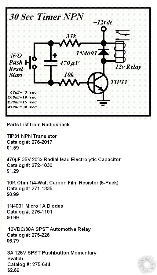

You could make your own for about 15 Bucks
time delay relay? -- posted image.

That's probably the way to go for most people, but if you don't buy parts from RS, building the circuit would probably only be about 50 cents over the cost of a $3 relay. If cost is a factor anyway.time delay relay? -- posted image.
