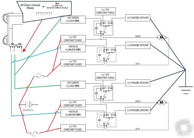

multiple relays for door locks? -- posted image.
What about the Second Unlock Output?  Above is what I envision.. Just want to make sure it is right before I spend another day wiring this up.
Page 14 shows I need Relays, not just a direct wiring.  I want to utilize the second push of the unlock to activate the passenger door.

You don't need 4 relays, 2 will cover all 4 doors, factory actuators draw about 3-6amps, aftermarket 5-7amps, thus one rlay for each direction is adequate for 4 doors, you will need a third relay only for priority unlock for the driver's door which to my mind is a bit paranoid.
So does this look right?

Posted: November 19, 2009 at 11:42 AM / IP Logged
Your last post rather confused me, the normal procedure as on factory locks is to lock all doors then the first press on the disarm/unlock button does the driver's dor, 2nd press other. any way my graphics are lousey so here's how you do it.
Alarm lock green or GREEN/ black model dependant 85 on relay 1.
12v+ to 86 and 87  on all 3 relays. Fused at 15amps.
Ground to 87a on all 3 relays.
Lock output to actuators on both doors 30 on relay 1
Alarm unlock blue or blue/black depending on model to 85 on relay 2
Unlock output from relay 2 30 to driver's door actuator
Alarm 2nd unlock wire to 85 on relay 3
Unlock output  from relay 2 30 to passenger door actuator.
There, it's that simple. To wear a belt and braces, for technical reasons wire diodes across the coil terminals 85 and 86 with the bands towards 86.

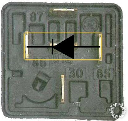

Okay, so here is what I got out of that last post.. Thank You sooooo much!!  I am a visual person... well.. I am male..  and  I have a cool app that helps me draw really cool graphics for the next person who decides that their 90's model corolla needs some upgrades.  :)
PS. I put diodes in the drawing, hope you can see them.. Question on that: Im guessing that I just bridge the diode and it will look like this.. see pic below:

Posted: November 20, 2009 at 2:47 AM / IP Logged
Absolutely correct, now tell me about your graphics app because I'm getting frustrated with having to "talk" these things out!
