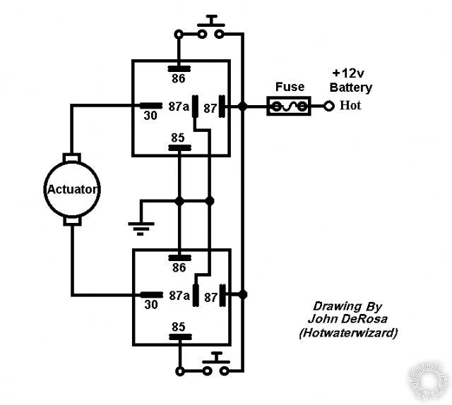

hotwaterwizard
Silver - Posts: 1,350
Joined: December 11, 2003
Posted: November 21, 2009 at 1:40 AM / IP Logged
custom door latch, switch, relay? -- posted image.
John DeRosa (Hotwaterwizard)
Stockton California
When in doubt, try it out !

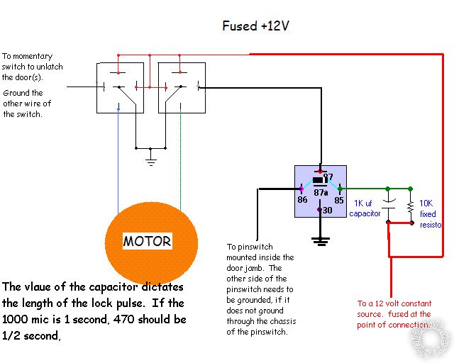

Platinum - Posts: 13,726
Posted: November 21, 2009 at 4:45 AM / IP Logged
To do what you are wanting to do, you will need a timed relay or a constant to momentary relay for the latch portion of your setup.  How long does it take for the actuator to go from unlocked to locked?
Posted: November 22, 2009 at 8:44 PM / IP Logged
You need a constant to momentary for the latch part.  If you are using a pinswitch mounted in the door jamb, it will have a relay energized the entire time the door is closed.  You need a pulse to lock it and then you want need the power to go away so it will not constantly be trying to insert the pin.  Is this correct?
Posted: November 23, 2009 at 5:32 AM / IP Logged
I have a modified version of the following diagram on my other computer.  I will be able to post it this evening.  The parts are al the same.  Modified drawing is for negative trigger and negative output.  You can get the parts today if you need.
Did you build the above posted relay setup yet?  If so I will have to modify the diagram to have a positive output.  If you have not built it, I will draw up the whole thing to work with a negative output.
Posted: November 23, 2009 at 6:39 PM / IP Logged
