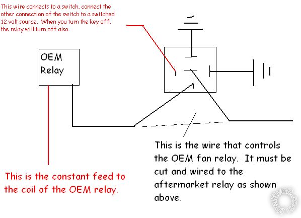

If so and only if that is the case, the following diagram should help you.
thermo fan manual switch -- posted image.

If the original relay is switched by grounding it, then you can simply wire a grounding switch in parallel.
(That means the relay solenoid is always hot +12V so the relay is actuated by grounding its other end. The same idea will NOT work on hot-switched system - something will blow!)
Older cars commonly used grounding for their horns - ie, a grounded horn button feeding a 3 terminal "hot" relay (or hot 4 terminal relay with +12V connected to contact & solenoid - say #30 & #86).
The core of the computer itself uses ground switching, but that will be buffered before it is presented to its output, and that buffering might change the signal to hot switching (ie, +5V or +12V output).
Ground switching is equivalent to "Open Collector" outputs as recently discussed at 12Volt's what is a 'pull up resistor'.
Platinum - Posts: 13,723
Posted: November 20, 2009 at 7:13 PM / IP Logged
He mentioned that the relay was controlled by the computer of the vehicle.  Grounding the wire without isolating it from the computer could cause problems.

Sorry I took so long to get back to you and thanks very much for your help guys,but I think I have bitten off more than I can chew [ so to speak ], yes I am aware of the implications that is why I didn't want to touch anything before I found out for sure if it would be ok.
I will try to explain as best I can, with an earthed testing light I can get a power out of one of the low fan relays connections, only when ignition is turn on, but nothing from the same connection when ignition is off.
So can I run a wire from that connection of the relay to a switch mounted on the dash somewere and then earth that switch to something close by ?
If it turns out to much for me, I will get a pro to do it, but I like trying to do stuff myself, if possible.
thanks again.
oldspark
Gold - Posts: 4,913
Joined: November 03, 2008
Posted: November 21, 2009 at 2:15 AM / IP Logged
Excellent info!
Alas no - yours is not earth switched.
If it was, 2 terminals would be +12V with ignition ON and fan OFF.
You may be able to parallel a second relay - ie, from +12V to the fan (and turned on buy a dash switch) - but that depends on the wiring - it could be damaging.
So it looks like you need to get a pro. (Rats!)
