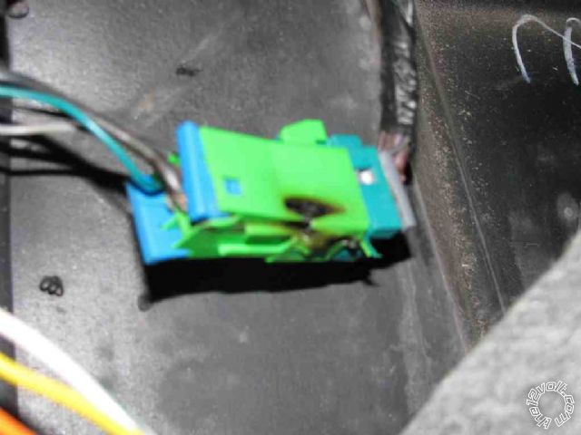

I recently installed a rs into a friends 02 Sunfire. Upon removing the drivers kick panel, I noticed a green plug which had been very hot at one time. One of the five wires in the plug melted through the plastic.I tested each wire, two of them show +12v with key on. The wire that did the damage is 12 guage and had no power when I tested. The rest of the wires are 14 guage. Anybody recognize it ?burnt plug -- posted image.

That is your defrost wire very common for that to happen.
Butt connect the two wires and call it a day

How could that be common? Really?
