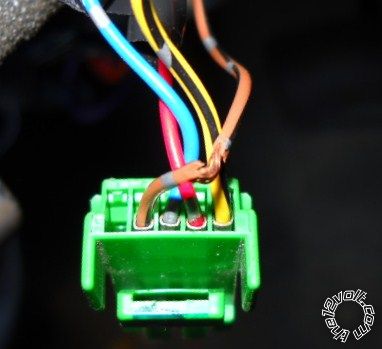

Posted: December 05, 2009 at 3:24 PM / IP Logged
Ok I ve found the connector with the wires you listed it comes from the black box with the  plastic ring around the ignition.
Now what wires from the 556HW go where? The install instructions are very unclear, as you see there are only 5 slots not 7 as stated by the instructions and only 4 wires.
The factory instructions for the 556HW mode 2 are here   http://www.directedstore.com/manuals/556HW.pdf

pitoaudiovisual
Copper - Posts: 388
Joined: April 25, 2005
Posted: December 06, 2009 at 2:47 AM / IP Logged
ok the orange and black of the bypass goes to the blue of the car. The red wire of the car must be cut in half the key side gets the yellow and black of the bypass and the yellow of the bypass goes to the other side of the red wire. the pink wire of the bypass goes to the yellow and black of the car. the blue and white of the bypass goes to the negative from the remote start. red of bypass is constant and black is ground.

spy1309
Member - Posts: 6
Joined: November 29, 2009
Posted: December 06, 2009 at 2:09 PM / IP Logged
Followed the instructions given still a no go, engine cranks but does not start., also if I connect the blue/white of the bypass to the negative output wire of the remote start even if I leave the key in the ignition still does not start, the soonest I remove the blue/white the car starts with the key in the ignition.
Also in the install diagram there is a green wire from the bypass who needs to be connected is reffered as the ,,refrence " wire, where that one gets connected?

pitoaudiovisual
Copper - Posts: 388
Posted: December 06, 2009 at 3:49 PM / IP Logged
are u doing the programming correctly meaning using mode 2 and verifing that it is in mode two with the led flashing twice and make sure u are using the black master key. as for the green reference  i dont kno cause it doesnt say where it goes and the only color u have left is brown and the programming does mention using the brown wire double check the wiring and make sure ur in mode 2 with the lights. if and only if u want to take a chance connect  the green wire to brown but i dont recomment it.
