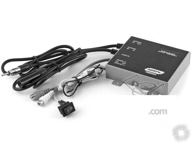

Platinum - Posts: 13,720
Posted: December 01, 2009 at 9:12 PM / IP Logged
An FM modulator is a device that takes a high quality audio signal and broadcasts it onto an FM frequency that is injected into your radio via the antenna cable.  The sound you get wil be only as good as your FM radio can make it.  Granted a wired FM modulator does MUCH better than their wireless equivalent, known as an FM transmitter.  They do still leave some sound quality on the table.  The aux in adapter will allow you to get the best sound possible.
And if you do use the following device you will also need to purchase about 20 dollars worth of antenna adapters
