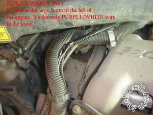

I expect this has been answered, but I have searched and an unable to find!
The information I have says the tach signal wire should be in the "big harness" in the engine compartment. It is a PURPLE / white wire.
I cut open the big harness and found a purple wire with a white stripe. I inserted a pin into the wire, and put an AC volt meter on it. While revving the engine, the voltage was around 2volts, and did not fluctuate.
Is this the correct wire?
How can I measure it? Is there a place to get a picture of it to help me confirm?

Velocity Motors
Platinum - Posts: 12,488
Joined: March 08, 2002
Location: Manitoba, Canada
Posted: December 06, 2009 at 9:24 AM / IP Logged
There is a thick loom of wires that run across the engine from the driver's side to the passenger side. It is split tube loomed aswell as the wires in there are taped up. Ther eis only one VIOLET/WHITE wire in there.

LittleB
Member - Posts: 23
Joined: November 01, 2003
Posted: December 06, 2009 at 10:40 AM / IP Logged
Thank you very much. This is exactly what I am looking for.
I cut into the wire that runs horizontally from drivers to passenger side as you say. It was a split loom with the wires all taped. I'm sure it is the same bunch of wires.
Should I be able to measure an AC voltage that fluctuates with engine rev?
Thanks again
