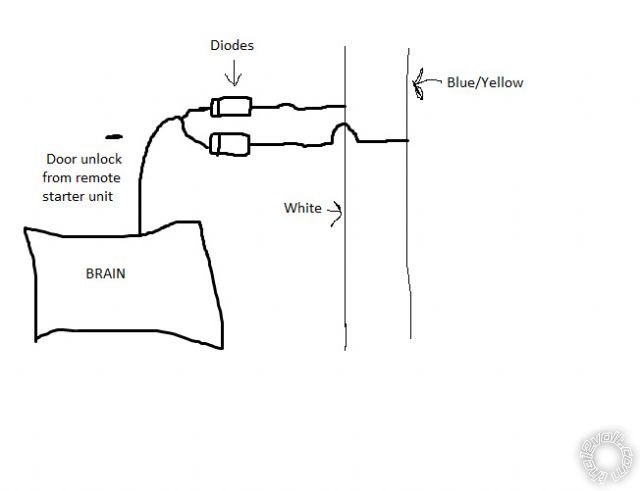

Im gonna try what T&T Tech said without using the white wire first. But just outta curiosity. I made a diagram of the conecept from what you guys said. Tell me if it's accurate. BTW THank you guys very much for the info. I also have another pose maybe you guys can help me out with when done with this lol
