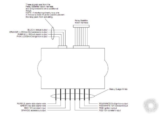

Thanks! I have previously checked all the battery and connections. Could the wire you're referring to be perhaps red? Of the heavy gauge wires going into the relay box, none are yellow. here's a schematic of the relay box. trying to bypass alarm system -- posted image.

Yellow wire on the vehicle, purple hooked to one side of it, and green hooked to the other side.
